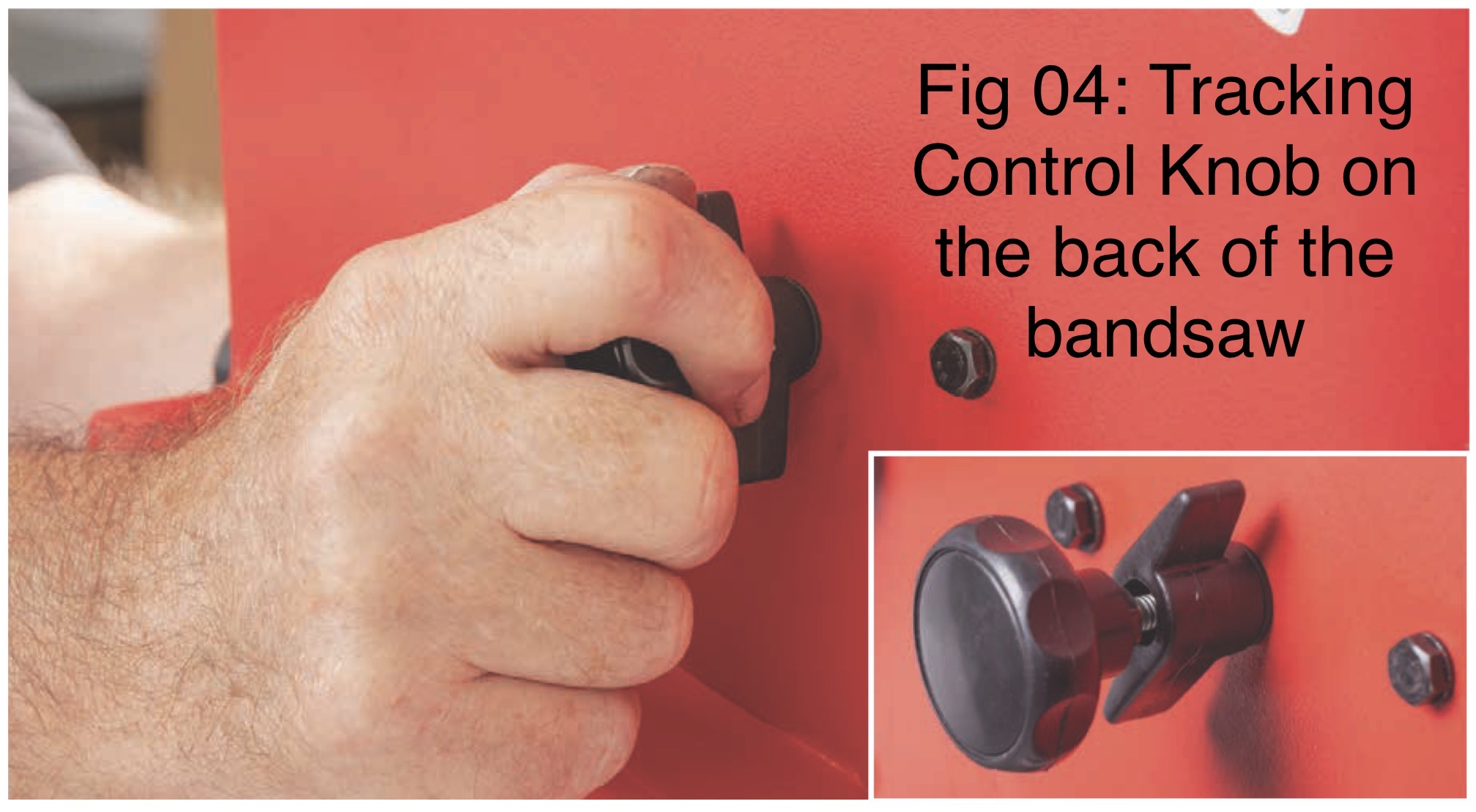

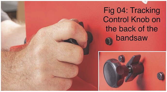

Sounds like the top wheels tracking needs adjusting. Page 8 in the manual. It’s one of the first things shown in the setup video.
