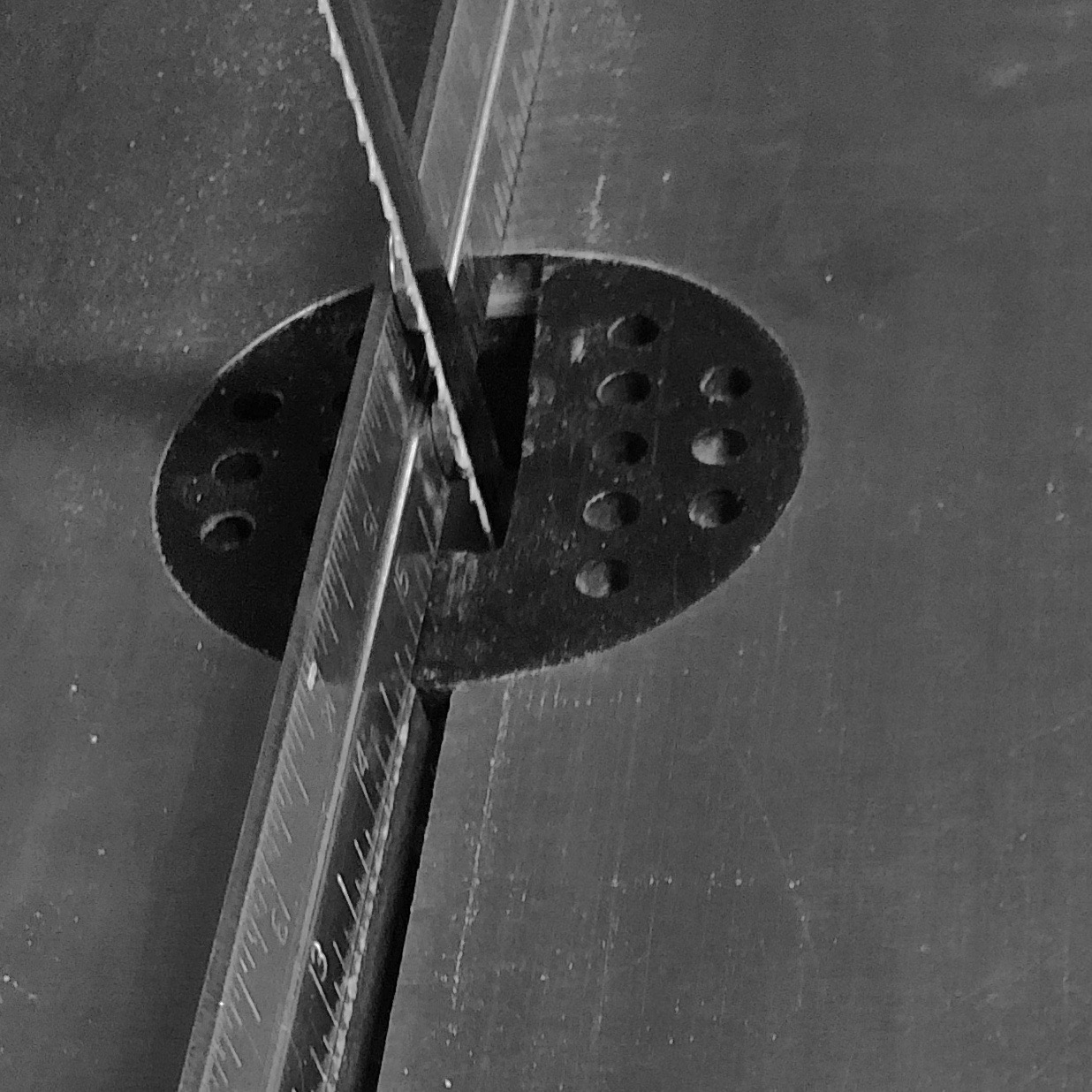

This is a useful guide from Axminster tools but when aligning the cutting fence make sure this fence aligns with the miter fence slot first and adjust the fence as necessary. Note some bandsaw cutting fences are fixed. And then adjust the table so the the blade aligns with the cutting fence with the bandsaw buddy.
If you don’t have a bandsaw buddy you can use a couple of button magnets on the blade and a straight steel rule.
